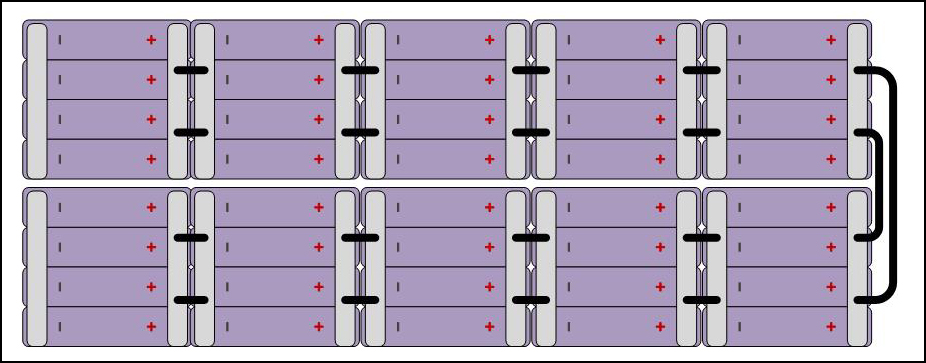

As an example for this lesson, let’s pretend you have a brand spanking new 10s4p pack (as it’s pretty common) and you are just dying to get it installed so you can ride! Damn dude, go for it, what’s the worst that can happen? Well, you could blow your silly ass up unless you understand what it is and how its specific values pertain to the rest of the electronics in your board.
So, back to the 10s4p battery pack. A 10S4P pack will have 10 cell groups in series, with each cell group having four cells in parallel. Before we get seeping into that though, let’s look at individual cells for a second.

So when you put it all together with four cells in each parallel group, and 10 parallel groups in series, you get a pack with 12,000mAh of power at 36 volts.
![](https://esk8.news/wp-content/uploads/2019/06/10s4p-complete-new.jpg)
At one end you have a positive lead and at the other end you have a negative lead. Don’t get them mixed up, those bastards bite and it can get expensive to replace.
